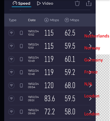

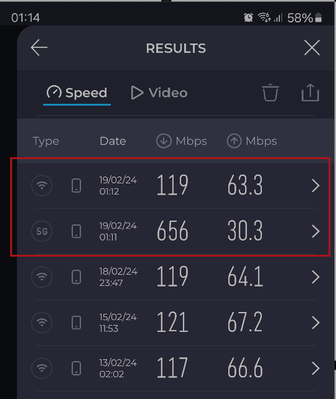

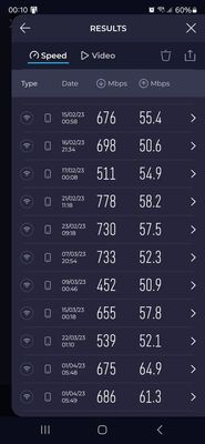

A further update to this - I made three send me out a brand new replacement router only 2 weeks ago at the start of Feb 24, so I could rule out that being an issue. I have a brand new replacement router (Zyxel NR5103), brand new sim card, and nothing changed. exactly the same and stuck at 120mbps. I have attached screenshots of speeds tests below and you can clearly see the moment they made the changes at their end on the 14/11/23, and from this point on my speed has been throttled to 120mbps, when the speed only 3 days before that was 544mbps.  I have also added screenshots of speed tests from Feb 2023, compared to speed tests from Feb 2024 and the differences are striking. My speed used to vary, as non throttled speeds should, between 400mbps up to 900mbps depending on the time of day/load on the network, as you would expect. Now, my download speeds have no variation at all, 7pm on Saturday evening at peak times, 120mpbs, 3am on a Sunday at the quietest time possible, still 120mbps. If speeds were not being throttled there would be a variation to the speeds I could hit. When I do the same speed tests on the Three mobile network when not connected to the home broadband, I get much quicker speeds, as previously mentioned, and I get the expected variation depending on the time of day. As I am about to post this, at 1:15am on a Sunday, I have ran a speed test on the 5G Mobile network and just hit 656mbps download, and then the speed test when connected to my home broadband, 119mbps, five and a half times slower!! Admittedly the upload speed was the opposite way around hitting 30.3mbps on mobile and 63.3mbps on the home broadband, but this again just shows that the speeds are being controlled and throttled. And again, I have attached the screenshot of this test below.

Speed Test Results showing change in speeds on 14/11/23 immediately after Three changed the settings their end -
Three Home Broadband Speed Test Results Feb 23
