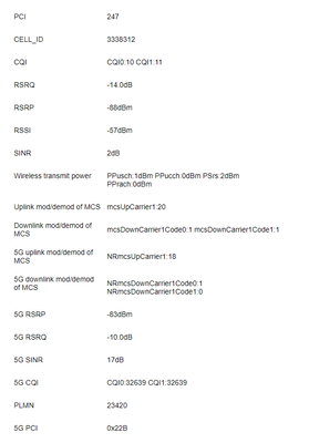

Can you please reply with a screenshot of the Cellular Statistics page from your routers admin portal? its the one that shows the CELL ID and Frequency Bands that you are connected to, along with the signal info such as RSSI, RSRP, RSRQ and SINR etc.

That's really helpful, thanks. Attached the info you mentioned but did a quick speed test and upload speed currently on the just about passable end of what i get (7/8Mbps) so might be this particular cell isn't the issue but another in my area (I'm London based). Router is currently sat by a window on the top storey, pointing towards where the nearest mast is (last time I checked anyway!). Am a top floor maisonette so that's 4 storeys up. No taller buildings in line of sight.

Sorry for the late response I was waiting for the mods to approve the image (I can see it now).
I have checked the mast details on CellMapper using that Cell ID you are connected to and it offers the following bands via several cells on that mast:
B1, B3, B20 (and N78)
From that image you've attached your 5G signal stats look good, although the 4G SINR is on the bad side.
