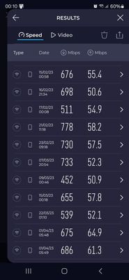

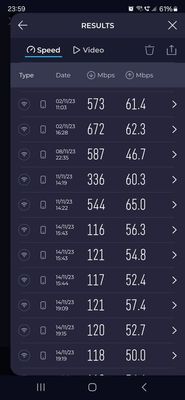

Hi All, just to say I am in exactly the position. I live right next to the 5G mast in my area, literally 30meters away. When I first went with three 5G broadband in October 2022, up until November 2023, I was hitting anything from 600 to 900mbps download, all the time, even peak hours, I still have all the results recorded on my ookla speed test app/account.
In November, disney plus stopped loading on my TV stating I was out of region, nothing I did/changed could get it to load so contacted three, who advised they had made some changes to my account and restart my router and try again. Sure enough disney loaded, but from that point on my download speed is stuck at 120mbps, won't go any higher. It jumps to 400mbps when the speed test starts and then quickly drops down to 120mbps and stays there, clearly they are throttling and limiting the download speed.

A further update to this - I made three send me out a brand new replacement router, so I could rule out that being an issue. I have a new router, new sim card, and nothing changed. exactly the same stuck at 120mbps. You can clearly see in the screenshot below of my speed tests, the moment they made the changes at their end on the 14/11/23, and from this point on my speed has been throttled to 120mbps. I have also added a screenshot of speed tests from Feb 2023, compared to speed tests from Feb 2024 and the differences are striking. My speed used to vary, as non throttled speeds should between 400mbps up to 900mbps depending on the time of day as you would expect. Now, my download speeds have no variation at all, 7pm on Saturday evening at peak times, 120mpbs, 3am on a Sunday at the quietest time, 120mbps.
