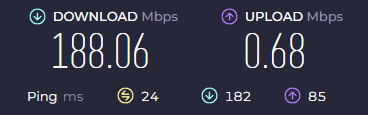

I have no complaints about the download speed. Upload speed is near-unusable. I'd get better upload speeds tethering to my phone's 4G hotspot (using the Vodafone network).
Despite all that, I'm mostly concerned about how awful my broadband's latency can get. When there's no other load, I reach about 55 ms on average in Overwatch 2. However, when someone is watching a film, or even uploading something, the ping rockets up to between 300 ms and 5000 ms - completely unplayable. This can happen completely at random too, and it's caused me to get competitive bans in the past due to disconnections.
Is there anything I could do to resolve the issue?

I've tried it with my PC wired in via Ethernet, but unfortunately, that didn't help. UPNP has also been enabled already.
The router is right beside the window, away from other electronic appliances. I have the Zyxel but it seems the signal is about the same no matter which windowsill I put the device on.
It seems like my ping has gone up lately too, hovering at about 90 ms!
