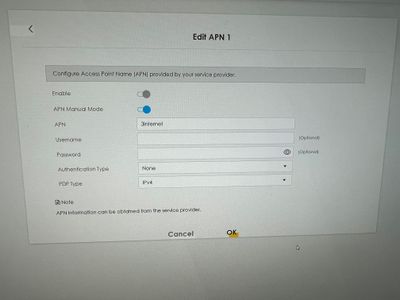

Hi, I have managed to find a workaround. It seems to happen with the latest firmware.
I did the following:
Log into the router with your admin credentials then go to Broadband, Cellular APN, click on Modify for #1, Switch APN Manual Mode on, change PDP Type to IPv4.
Should now work.
