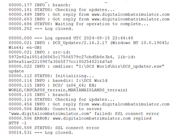

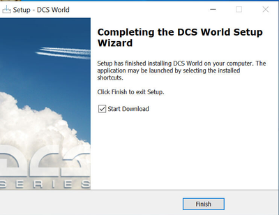

Thanks for the reminder. So before, when I downloaded the installer, I did press continue and it started downloading fine. That will have likely been because I had just left the actual website of course, so just how it works for me on my game PC. So I kept the installer, and uninstalled the game installer. I then hopped back to that PC and sure enough, on a clean install after the previous above picture, the same SSL socket error on loading followed by DCS's own log file, like my previous errors I've been able to replicate where it will not kick in. Of course other people have similar ways to replicate the errors with git pulls too, but its handy to have a known other app that reliably fails that isnt a webpage.

I have downloaded the DCS installer and remoted to my old HTPC, will give it a while then try and run the next stage to see if works, as page has been opened recently so would work - in case useful for any testing point of view to replicate non web browser issues
