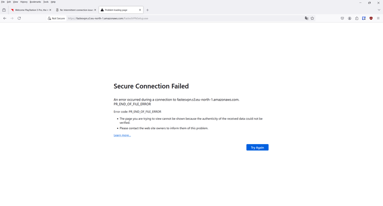

Is anyone else occasionally getting a 'connection down' error from Chrome (or 'Secure Connection Failed' from Firefox) when changing page - if I hit refresh it works fine. At first I wondered if it was the site I was using but have noticed it on multiple different major websites over the past couple of months and not noticed it from other locations where I don't use Three Broadband so does seem to be related to the router/connection (this is via wired Ethernet too, so not a WiFi problem). I've tried changing DNS server in case that helps but no difference.
It mainly seems to happen when trying to first load a site or (annoyingly) at checkout when a different site is being loaded as part of the checkout process. It certainly doesn't happen everytime but does happen with reasonable frequency. I've also noticed I often get it when trying to pull/push from/to Github too and have to do so a number of times for it to work (browsing the Github website works fine).

Intermittently (ie at present) it seems to be OK for me. I'm loathed to say it's fixed because I'm sure in another day or two the problem will probably be back again. Really seems to me like it's some kind of intermittent issue to do with which of their servers does your packet inspection and if you get a dodgy one then the dropped packet issue (if that's what it is, seems that way?) starts kicking in.
Sometimes when I get reassigned a different IP address after being reconnected for whatever reason the problem just magically disappears. Then I'll get reconnected again later and the problem comes back. Presuming you're assigned a certain 'route' through the Three network (ie for packet inspection) at the point that you reconnect to the service (ie get a new IP address etc) then you're stuck with the problem until you reconnect again.
Lot of presumption...
Maybe with that Cloudstrike issue last week some of their boxen went down and they had to reboot and it's magically fixed the issue though eh?!
EDIT: having said above it was OK at the moment, I've now had the PR end of file SSL thing pop again on Morrisons grrr

Same. Still seeing regular SSL errors.
Also had issues with downloading packages using PIP and APT since I've been setting up some new systems. Often see them either quit out dues to failed SSL or occasionally the download just gets cut off partway and fails. Doesn't happen when using a VPN..

I found this thread since I'm having problems connecting to an FTP Server using TLS. It just won't work 😞
I then hit a problem trying to use an API call, which again just refuses to work from within my network. Doing various tests it looks like SSL/TLS is being blocked which I think is a related issue, similar to my FTP TLS this morning.
