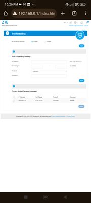

Guys just tried port forwarding and everything work like a charm.  The key is that you can't reach public ip and forwarded port from the network itself. You need to setup it and check it via other network e.g. your phone with mobile internet (not the same as in router) and it works. But if you will try to do it from router network it will not work!
A screen shot for my port config:
Caz
Unfortunately, your screenshots is blurry at this end, but I'm glad you managed to get port forwarding working. I've been with a few other ISPs prior to Three, and have never had any  such issues before.
