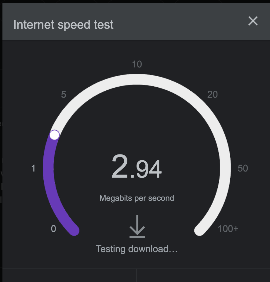

This has been my 5G home broadband speed for the last few hours....are there known problems with the 5G service? It was great for the first three months I had it and now it is either really slow or needs a total reboot once every 24 hours.

I had this issue for about a week and came *this* close to throwing the router off a cliff, but found a solution which means my average speed is constantly over 100mbs, and near enough 100mbs during peak hours - log into the admin settings > go to network settings > go to broadband > under brand management set the auto selection to off, and check n78/b28/20 and hit save. On the same page, the preferred access technology should be set to NR5G NSA 4G Auto Switch (which i think is the default).
I was *this* close to calling it quits with the Hub, but this solution has been working for the last few days.

Great thanks I'll give that a go. I am having to reboot the thing more and more regularly so I guess it's about to give up the ghost soon enough.

Band management can be a hit and a miss, it all depends on the bands transmitting locally, but it can help force the router to connect to a different mast from the default one that is selected automatically by your router. It's worth experimenting with N78, and a combination of available B bands to see what works as this may be subjective to where you are.
