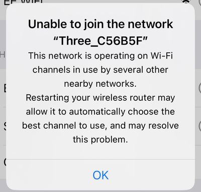

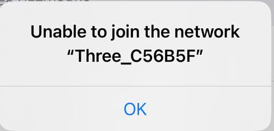

I have had Three 5G Home Broadband for three months and in the last few weeks I have started to encounter an issue whereby my phone (iPhone) often won’t connect to the network via WiFi. I get a message saying ‘Unable to join the network’ (see attached screenshots). This is also happening for other users of the WiFi network on their iPhones, iPads etc.
I have restarted all devices (including the router), forgotten then re-added the WiFi network (which sometimes provides a temporary solution, then disconnects again a few hours later) but keep encountering the same issue.
I understand that up to 65 devices can be connected to the Three 5G Broadband at once. There is a maximum of 7 devices connected to this one (two iPhones, two iPads, two laptops and one speaker system) so it shouldn’t be related to that.
Has anyone else had this problem and if so did you manage to solve it? Grateful for any advice.

Oh, that's an odd issue. It sounds like the phone error is highlighting that there's congestion in the area on whichever WiFi channel it's referencing. It's not clear which frequencies it's trying to use either, 2.4, or 5Ghz.
It might be worth experimenting a bit with the WiFi settings on the Hub. Try choosing a different band/channel manually, or try turning 2.4Ghz off, sticking with 5Ghz only, and the other way around too. If one of the things you test works, it might point you in the direction of what's gone wrong.
You could also try using a Network Scanner to determine what other wireless networks are operating around you and use this to decide which channels to avoid.
