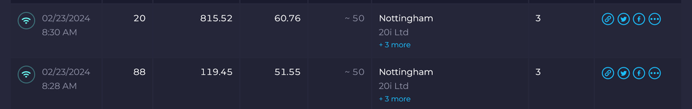

My experience with changing the APN is exactly the same...Tests done 2 minutes apart, just using different APN! Absolutely disgusting from Three, I too will be getting in contact with Ofcom and the ASA (with whom I have had very good experiences with in the past). Three cannot be allowed to simply get away with this dishonesty and false advertising. This all done using the same equipment, so the ONLY explanation is that they are indeed using speed throttling on certain customers/sims/numbers despite specifically stating no speed limits. Scumbags.

Throttling Tests & Resolution with APN Change
Hi All – I spoke again to technical team on 21/02/24, who were useless like usual, who passed me through to the complaints team again as they said they could not work out why my connection was maxing out at 120mbps and why it had changed and were still adamant they don’t limit or throttle connections! I’m being more convinced now that the technicians truly believe the connections aren’t being throttled, but there is something going on higher up above them doing this, that they have no control over!
Anyway, after I had finished with the complaints team, I did a little more digging around and went into to the router settings to check the APN Access Point Name) which there are many posts about and has been mentioned on here. The APN was set to automatic and was ‘3internet’. On reading up it seems ‘3internet’ is the standard one used for broadband. I changed to manual rather than automatic APN and used ‘three.co.uk’ instead, and then did a speed test and 584mbps!! After all this, for me all that was needed changing was the APN, and I should have checked this earlier as other posts suggested.
I tried the following APN’s and all of them worked without a download limit apart from the ‘3internet’ one which is clearly being throttled-
3internet – 120mbps
three.co.uk – 543mbps
3broadband.ie – 567mbps
3ireland.ie – 532mbps
open.internet – 578mbps
So frustrating that no one from the Technical know this or could have suggested changing the APN and even more frustrating that everyone from Three are still adamant there are no speed limits and they don’t throttle – it’s obvious they do, and even more so from the further testing I did below!
