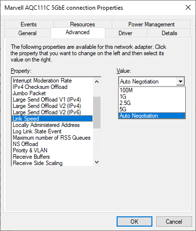

Can you take a screenshot of the advanced options you have available under devmgmt for the network adapter? I know the options differ between adapters so don't want to give blind advice 😂
Just wondering if there's any options you can change and test from there to see if there's any difference, such as manually setting the link type and speed etc.

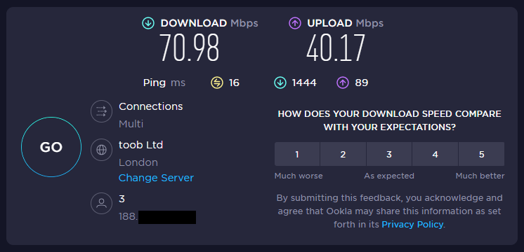

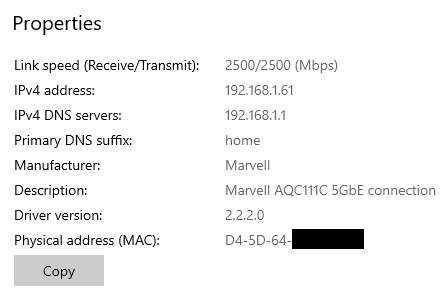

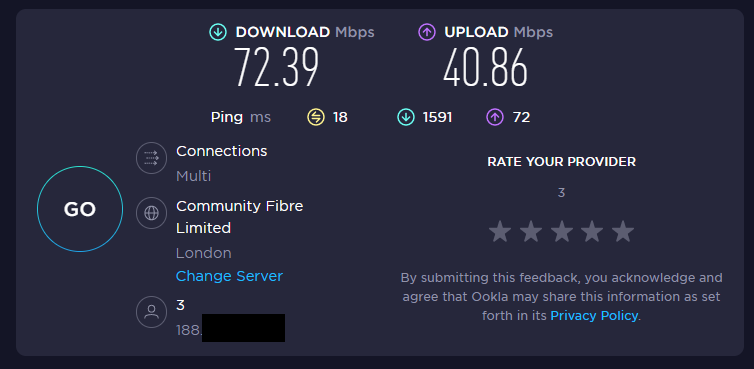

@crypt0ninja Cheers for the suggestions. Sorry I had a driver from 2020 installed, not sure why Windows was adamant I had the latest driver installed but thank you, I found the mega.nz link with the 2022 driver. I also had the cable plugged into the bottom NIC, once I plugged it into the top NIC, the link speed in Windows went from 1000/1000 to 2500/2500. However, even with this new driver and the NIC swap, it didn't help much at all. I can now barely get above 70Mb/s download at the moment of writing this, probably because it's peak time? But again testing with my phone, I get a respectable 430Mb/s. The Link Speed under the Advanced properties of the Marvell NIC was set to Auto Negotiation. I did try to flip between static/manual settings, to no avail. I have attached all the pics below...
@PeteG Cheers for the suggestion, the cable I used before was unlabelled so not sure what category it was. However, I did have a brand new CAT 6 cable in my drawer which I was using for these latest tests which didn't help much.

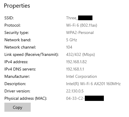

I also tested the speed on my PC using a built-in Wi-Fi adaptor (Intel(R) Wi-Fi 6 AX201 160MHz) and I get the exact same speeds (almost to a Tee) of around 70Mb/s. The driver for the Wi-Fi card is 6 months old from 2022.
Pics below..
Advanced properties of Marvell NIC:

Speed test from a PC connected to the 5G router via Marvell AQC111C 5Gb Ethernet:
Marvell LAN NIC Properties in Windows:
Speed test from a PC connected to the 5G router via Intel(R) Wi-Fi 6 AX201:
Intel(R) Wi-Fi NIC Properties in Windows:
