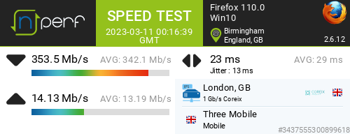

bulldog555
Involved
It's happen to me as I ended up put the 5G Hub in the loft as the upload getting better now
Before was: 450 to 625 / 5 to 8
Now in loft was: 525 to 700 / 11 to 20
