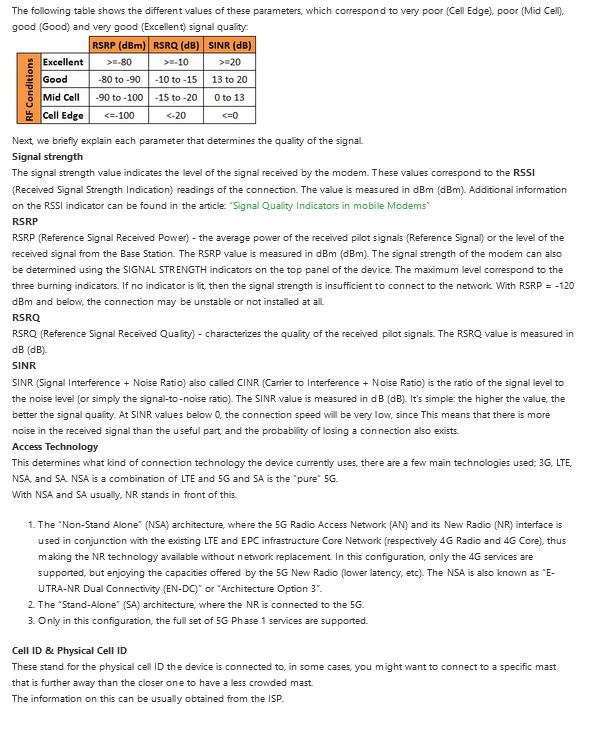

bulldog555
Established
You have to remember 5G only work with 4G alongside it because Three use NR5G-NSA (none stand alone) at present time mean have to use both 4G and 5G to get 5G working properly.
martcoug1
Regular
The issue is, you need a good 4g signal too, it uses this for upload unless you can cell lock... Three 5g uses NSA not SA... yet
craigs85
Regular
Ah, so upload uses 4G, of which I do have a much weaker signal.
How do I cell lock so it uses 5G?
bulldog555
Established
There is no cell lock on this router sadly with current firmware B12

I'll still have a walk around with the hub and see where I get the best results. So lower RSRP = better, and lower SINR = better?
I could sacrifice some download speed for a bit better upload if this is possible 🙂
bulldog555
Established
You need to read below
