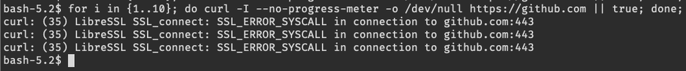

I'm using the following one-liner to test; it uses Curl to connect to github.com 10 times, ignoring the output but printing any errors. I'm attaching a screenshot of its sample output.
for i in {1..10}; do curl -I --no-progress-meter -o /dev/null https://github.com || true; done;
3 failures out of 10 connection attempts3 failures out of 10 connection attempts
