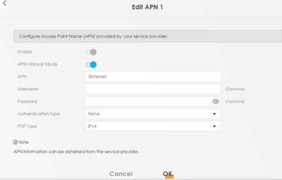

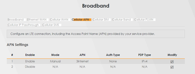

NR5103E.  Had it 10 months, no probs - always connected.  Then router lost connection overnight.  Restarted it.  Internet & smart devices connected but not Work VPN.  Arrived here 🙂  Took these steps to solve:
On side bar...
Network Setting > Broadband > Cellular APN
Modify #1
To this...
OK, restart router.  2 mins later all is well with my work VPN connection and is as quick as before.
